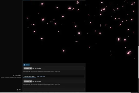

@Siropu, if I upload GIF, WebP, PNG, or JPG. They're working to be fine with good pixels, and if I upload an MP4, it will be large on AdminCP at Ads Manager > Edit ad (Banner). The same as the dashboard / home page has an issue too.
Also, if you put a link at the target URL, the video cannot be clicked anytime. Only an image or animated GIF can be clicked on dashboard / home page.
Only on the dashboard/home page for a fixed video large width with PC and Mobile responsive "extra.less":
.samBannerUnit[data-position="container_breadcrumb_top_above"] {
    .samItem {
        line-height: 0;
        overflow: hidden;
    a { display: block; }
    img,
    video {
        display: block;
        width: 100%;
        max-width: 1065px;
        height: auto !important;
        aspect-ratio: 1065 / 171;
        object-fit: cover;
        object-position: left center;
        border: 0;
    video { pointer-events: none; }
@media (max-width: 650px) {
    .samBannerUnit[data-position="container_breadcrumb_top_above"] img,
    .samBannerUnit[data-position="container_breadcrumb_top_above"] video {
        max-height: 80px;

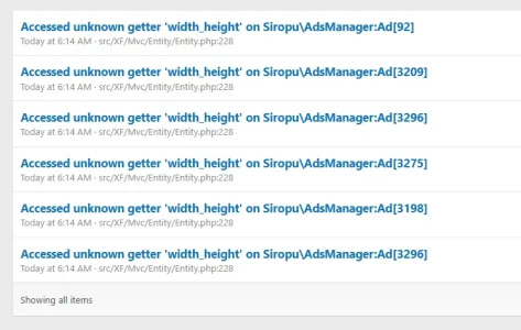

I can't disable a placeholder, unchecking and trying to save I get:
ErrorException: [E_WARNING] Undefined variable $ad in src/addons/Siropu/AdsManager/Entity/Ad.php at line 2089
XF::handlePhpError() in src/addons/Siropu/AdsManager/Entity/Ad.php at line 2089
Siropu\AdsManager\Entity\Ad->_postDelete() in src/XF/Mvc/Entity/Entity.php at line 1726
XF\Mvc\Entity\Entity->delete() in src/addons/Siropu/AdsManager/Entity/Package.php at line 317
Siropu\AdsManager\Entity\Package->disablePlaceholder() in src/addons/Siropu/AdsManager/Admin/Controller/Package.php at line 568
Siropu\AdsManager\Admin\Controller\Package->Siropu\AdsManager\Admin\Controller\{closure}() in src/XF/Mvc/FormAction.php at line 200
XF\Mvc\FormAction->run() in src/addons/Siropu/AdsManager/Admin/Controller/Package.php at line 88
Siropu\AdsManager\Admin\Controller\Package->actionSave() in src/XF/Mvc/Dispatcher.php at line 364
XF\Mvc\Dispatcher->dispatchClass() in src/XF/Mvc/Dispatcher.php at line 266
XF\Mvc\Dispatcher->dispatchFromMatch() in src/XF/Mvc/Dispatcher.php at line 121
XF\Mvc\Dispatcher->dispatchLoop() in src/XF/Mvc/Dispatcher.php at line 63
XF\Mvc\Dispatcher->run() in src/XF/App.php at line 2840
XF\App->run() in src/XF.php at line 844
XF::runApp() in admin.php at line 15
Also this is probably user error, but my placeholder is a missing image icon. No text. No background color. Even with the Advertise Here link enabled. What is causing that? Package is banner with 0 ads.
Problem now is, can't remove the broken image icon because can't disable placeholders, double whammy! 😭😭
