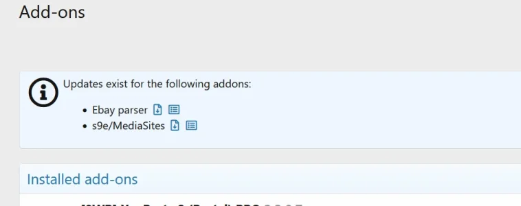

Just a quick 'credit given where credit is due' post from me....
This bit is awesome, saves so much time and work scrolling to find the add-on that needs upgrading. Quick reference to which add-ons have upgrades, one click to download the upgrade, one click to start the download (standard XF proceedure), job done
Awesome add-on, keep up the good work @mazzly (y)

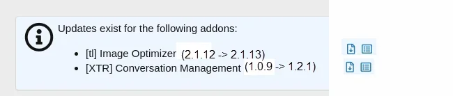

Updates exist for the following addons:
  • [Liam W.] Post Macros
Nope, it's already up to date.
This is because the page at https://xenforo.com/community/resources/liam-w-post-macros.5631/ has a string that is not "standard XF version", we can sometimes work around this on the backend, but in this case the new version is 5020230 which is equivalent to 5.2.2 Beta...
@Recep Baltaş you can click "ignore this version" to get rid of the notification until next time it changes :)

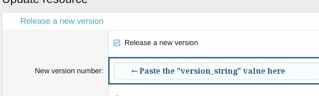

@XenSoluce please read https://xf-addon-update-notifier.com/how-does-xf-addon-versioning-work :)
  • TL;DR; When releasing a new addon version, set the "New version number"-field to match the addon.json version_string-value (and don't modify that value yourself, xf:addon bump-version sets that for you...)

You should use the value of version_string from the file addon.json of the add-on :)
Then our backend can understand it and map it to the correct version.

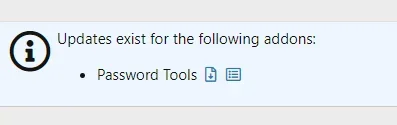

Already up to date but getting a notification.
Core: from our backend, I can see your forum is on version 901120090 while version 901140170 should be available (other forums are using it), maybe you need to update the license or similar to get a newer version? 🤔
Nodes Icon Tweak: It seems they have used the wrong version for that release, so I put it in our backend to match and ignore the "correctly parsed" version. Hopefully, for the next release they will have it correctly set :)
Downloaded again. Rebuilt with overwriting existing files. Still not up to date.
If you unzip the add-on file and open the addon.json file, what is the value for version_id ?
The newest version is 901140170, if it doesn't contain that then they are not giving you the latest version for some reason 🤷‍♂️ 🤔
