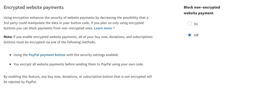

Okay, it looks like this was the fix:
192016
I had to turn that from "On" to "Off" and it solved the issue.
Is this a thing with XenForo, where the "Purchase" buttons are not encrypted using one of the methods?
Correct.
Surely turning Off encrypted website payments is a security risk and opens your site up to fraudsters?
No, not really. It's about preventing someone from manipulating certain code (I believe by using an extra hash). There's no point in attempting to manipulate this in XF though, as we validate that the components are what we expect (the amount paid, person paid, etc).

Thanks for confirming this Mike! I thought I was going crazy.
Glad I was able to resolve this one! Lesson learned!
