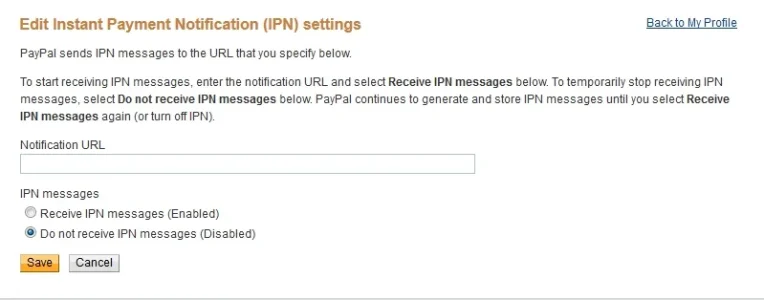

On PayPal you can check the ipn history to see if there are issues there. Go to ipn settings and click on view history. The interface is abit odd. By default it only checks the last day but you can choose a date range.
That is interesting. I had similar issues some months back and found where I had posted about it here in a different thread. I then added the correct URL and things were working fine until recently. I have no idea how or why the IPN notifications were disabled and the URL removed!? I just put the correct URL back in there and re-enabled notifications again. NOW I can see the history page, but the search feature isn't working!! PayPal gives me an error message saying that it cannot do the search because of technical problems... GAHH!
I hate that it seems like every time I get something fixed, they change something that makes it stop working...

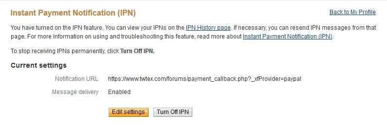

So I just got this email from PayPal,
Please check your server that handles PayPal Instant Payment Notifications (IPN). IPNs sent to the following URL(s) are failing:
http://www.twtex.com/forums/payment_gateway.php?method=paypal
If you do not recognize this URL, you may be using a service provider that is using IPN on your behalf. Please contact your service provider with the above information. If this problem continues, IPNs may be disabled for your account.
Thank you for your prompt attention to this issue.
Thanks,
PayPal
Note the "http:" instead of "https:"
But when I go to PayPal and check my settings, this is what is showing,
It is a totally different URL than what they are sending the notifications to! I am wondering if this is why notifications got disabled previously?!
That is the vbulletin callback URL.
Those members will need to cancel any existing recurring payments set up under vbulletin and resubscribe in XF.
I had no clue that the callback URL is set at the time the subscription is made. Thanks for clearing that up!
