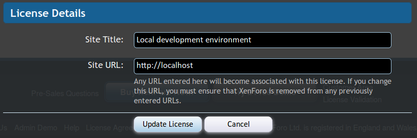

2. The whole site will be using xenForo and I am wanting to have some kind of home page with maybe some kind of widgets, articles or something else and have the forums under the "Forums" tab. So, when I buy my license, do I list the main domain (www.example.com) or (www.example.com/forums) on the license?
Pretty sure licenses are by domain, Looks like it just wants a URL - so give it the full URL (with /forums). I doubt they'll mind anyway as long as you're not using the license in more than one public place - it'll probably be obvious where the XenForo installation is.
XG6voH_TQBzZBQ
This one I was seeing conflicting information on the web about whether or not xenForo wants the exact location where the forums are or if they just wanted the main domain name. I just wanted to get it right and comply with the exact requirements for the license. XF will be on the main www.example.com url on down the line (no-subdomains) with the main forums at /forums so I wasn't sure exactly what they wanted.

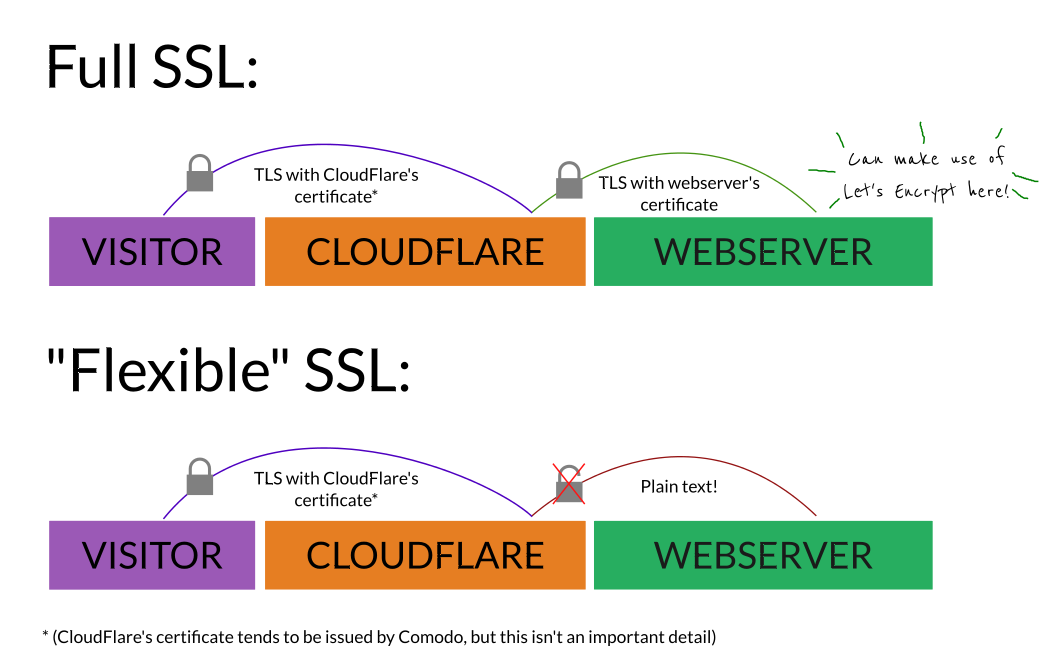

If you're going to use CloudFlare, they basically act as a man in the middle so you'll probably do both - use CloudFlare's TLS and also set up your own using Let's Encrypt. They offer two SSL/TLS modes, "full" and "flexible". Here's a quick diagram:
What you'll usually end up doing is setting up SSL/TLS as normal on your webserver (perhaps using Let's Encrypt or another certificate authority) and then using CloudFlare's "full" SSL option. It's named as such because both visitor-CF and CF-webserver is encrypted. This is the best practice approach and means that your site will still be accessible securely even if you move away from CloudFlare in the future. CloudFlare can then also verify the certificate is valid itself. The "flexible SSL" approach doesn't require you to set up HTTPS at all on your webserver and only the Visitor-CF connection is encrypted. This isn't great , it's misleading to visitors and you need to trust that there's nothing between your webserver and CloudFlare that would intercept traffic.
There's another approach you can use not documented above: CloudFlare can issue you a certificate themselves that *they* trust, but this won't work in a browser if you ever decide to move away from CloudFlare in the future.
To answer the question, yes - a Let's Encrypt cert is still trusted by the browser and you'll get a green lock:
