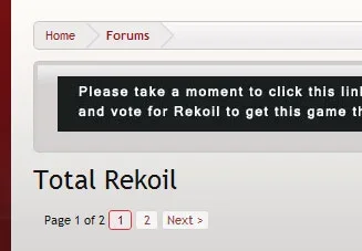

For some reason, I have some paging appearing on my forum homepage. This is somehow coming from XenPorta (I believe) as if I click page 2, it takes me to the last article which would have been the very first one I promoted. I just don't know why the paging is appearing on the top of the forum homepage.....
