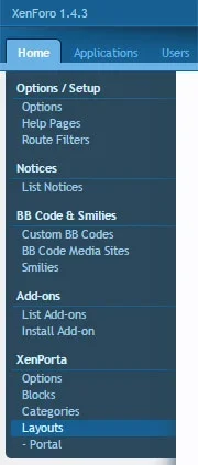

When you define a layout for the portal there's some kind of hierarchy that determines where this layout will be propagated to. In your XenPorta options you'll see the following hint under the "Globalized Custom Layouts" section:
By default, only the Portal uses the Layout Framework. You can enable the framework for various sections of your website (as well as enable articles mode). If you enable the framework for a section, you must define a custom layout for that section, or it's fallback.
Take note of the sentence highlighted in bold. So in your XenPorta options, if you've got a check against other sections in your forum (e.g. article, index, forum, etc) then you must define a layout for that section, or the fallback will be used. In this custom layout, you can remove the "offending" block that you do not want to appear.

Do you have a link, or screenshot, of what your 'forums' layout currently looks like?

This is where I was headed: I had a feeling he was confusing the terminology between 'index' and 'forum', and seeing the screenshot would have confirmed that.

Make sure you check the "Forum" checkbox in the "Globalized Custom Layouts" (currently not checked in your screenshot), in addition to applying the template modification to the 'forum_view' template.
Do you have layouts created for both index and forum?
Did you modify the forum_view template correctly?
Is the modified template in, or inherited by, the style you're actually using?
