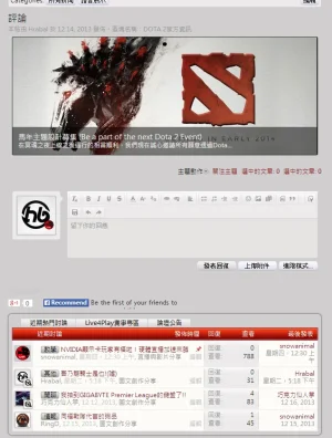

Once I've activated the blocks of RecentFeatures & RecentThreadx5, they also shows under the thread and comment box. Could someone else help how to fix the bug? Thanks in advance
I use:
>XenForo 1.2.3
>XenPorta (Portal) 1.6.0
