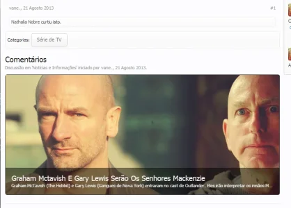

Ya, this is what I'm seeing: http://imgur.com/nnKE9B8 (edited, actually shows all articles on page 1). I'm using the most recent version of XenPorta and Xenforo.

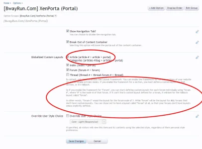

Dont make template edits... the rules of layout inheritance are explained right in the options in the admin CP.
I appreciate you taking the time to reply, but I've read that description many times and have tested things for hours and I'm still experiencing the issue in this image: http://imgur.com/nnKE9B8
The explanation in your image is hard for me to follow, and I'm still not entirely sure I understand how the article section works. Regardless, I still can't see why recent posts/articles would show between the top post and the comments... (please see my image link)
I have article selected and have a custom layout for articles but I'm still having other threads/articles nested between the actual thread and the comments (replies to first thread).
Move recent threads from Top-Right to Mid-Right.
Everything is inherited from the portal layout, except the mid-right section. So you either need to move the item into the mid-right section, or make an articles layout... which you don't seem to want to do.
Ahhh okay I understand how it works now. I didn't understand how things were inherited. I had an articles layout but not an article layout. Thanks for clarifying this for me, I appreciate it.
