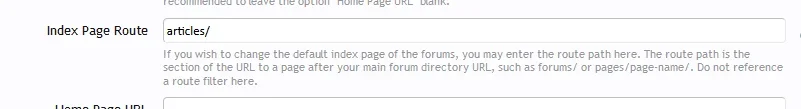

My forum is installed in my root directory. When going to mysite.com it takes me to the portal because I have this set:
By doing that it will make it so your forums load via mysite.com/forums automatically. Currently on your site when I try to access the root domain(no /forums/ I get a server error. I'd look into moving that.

For what it's worth it's not just this product it's a default xenforo functionality. Our main site for our styles is run by a page, the index route is set to: /pages/home or whatever which it turns our main domain into the home page and shifts the forum list to /forums/ You could set the index route to anything you wanted too and it would shift the forums into /forums/

You aren't inserting code to make it act logically. You are changing the route. By default the route is set to /forums/ you are just changing the route to /articles/ so no code is being changed to make it work just a setting. Even with just xF in the root folder by default it's still going to show http://mysite.com/forums/ in the address bar.
