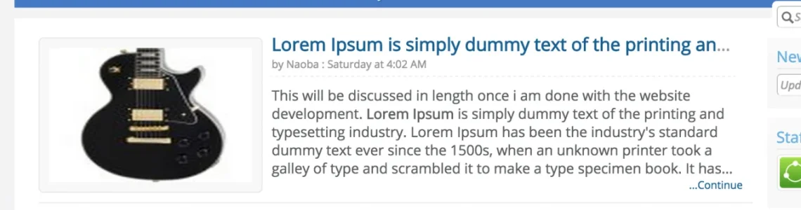

Hey Jaxel, could you please tell me if there's an option for disabling the "addthis toolbox" in the article view? thanks in advance, Martin

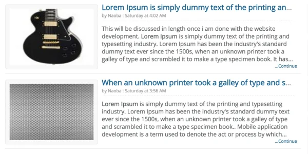

@Jaxel where have the "Show Full-sized icon instead of thumbnails" option from XP2? I need that to get big thumbnails like this
right now the image is stretched because of the fixed width... is there a way to shrink the size proportionally based on the thumbnail container ratio?
Why is it fixed width? Edit your template; because thats not default.
Yeah... disable it in XenForo.

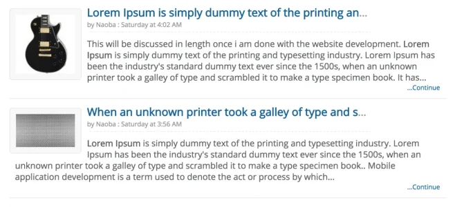

i know it's not the default, which gives me this. The thumbnails are too small in this.
i am trying to achieve a uniform look with my Showcase look (example: http://xenaddons.com/showcase/member/bob.4/ ) . I am trying to get a similar thumbnail size on my XP2 article list by trying to fix the width x height... but yes, the issue is the image is stretched non proportionately.
It'd be great if you could help.
