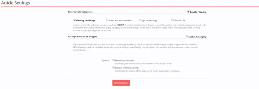

Why does this
Hide the Slider?
and how can I sort categories and keep the Feature slider visible?
My bad, didn't realize you had to manually add the slider, beside enabling it in options
