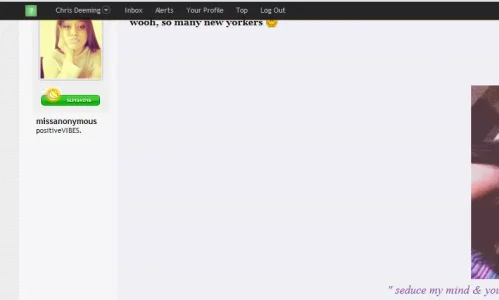

This is an issue on your own site too, 8thos.
Look, if I go to a specific post on your forum:
Notice how the post text is partially covered?
It's not so much of a big problem on your site - your custom style must have some extra padding in there somewhere.
But others are experiencing a whole line of text missing. At first I was kind of like "meh, what's the problem" but now I think about it, if someone clicks a link to a post, and they're taken to what looks like it could be a blank post (because it's only one line of text and that whole line is covered) then it's not the best experience.
