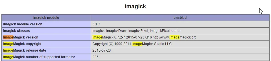

I have installed and enabled imagick extension along with checking the ImageMagic option in the ACP.

I feel like we've seen this sporadically with users of XFMG. Generally some combination of upgrading/downgrading ImageMagick or the imagick extension usually solves these things.
@Steve F, give me a yell on Slack later and I'll see if I can take a look at it for y'all. It is probably something in the LS PHP compile or possibly the CentOS install (if that's what you used on it).
