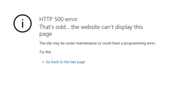

Recently users have been unable to register at my site. I tested it out to see what the issue was and apparently it's throwing the error provided below. I switched to a new server and got an SSL cert so that may have something to do with it. I thought that perhaps the outdated HTTP board URL was the problem but I fixed that and it's still not working. Any ideas?
