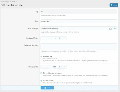

3. Create at least one die​
In the Asset Upload field, will appear a small preview.
Tag: The tag is fixed, like it is for custom fields also. But its not shown to the public.
Title: This will be displayed at several ponts.
URL to image: If you want to display the die with a special Background image. otherwise a default fallback will be used.
Big: The image will not be used. This can be used, if you only want to display the result like ✂
Values: If you don't wat to have a default die, you can specify the values on the sides. The values can be comma seperated, and the system understands ranges like: 1-3. If the entered values are less than sides, they will be taken multiple times. For Instance if you create a 10 sided die, and you are entering only 5 values, all will be twice on the die. But, this makes no sense. In this case you can just build a 5-sided die. ;)
Numeric die: Tick this box, if the values on the die are numeric. Only Numeric dice can build sums, can crit and can explode.
Display order: Yea, you know this.
Help Page: If you tick this option, this die is visible on the help page. You can use this, if you have too many die, to keep the help page short and clean.
Die can rolled: If this die is probably replaced by another, but should remain active, tick this. If a die is rolled in the past, and you don't want to use it anymore, but it was used before, use this option to deactivate the die. If you delete it, all old rolls may run into trouble.
