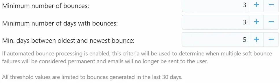

If you continue to get these soft bounces, they will eventually turn into hard bounces, based on the XF settings:
