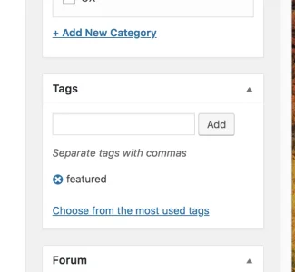

Created an article at Wordpress and add the tag "featured" doesn't work for me ?? May be because of some other problems at my site (Creating an article at WP does not also create a thread at XF because of some error logs at XF)Hey guys will organize all issues and respond to any questions in a bit. Real quick for those who were wondering about featuring a wp post, just add the tag 'featured'
May be due to setup. I'll look at tickets, mostly no errors so far besides the unclosed template tag. Mostly just install issues so we are going to try to improve that with a test tool of some kind.Created an article at Wordpress and add the tag "featured" doesn't work for me ?? May be because of some other problems at my site (Creating an article at WP does not also create a thread at XF because of some error logs at XF)

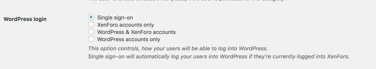

Can I eliminate WordPress login completely and use only XF login? What about social login addons for WordPress, what happens there?

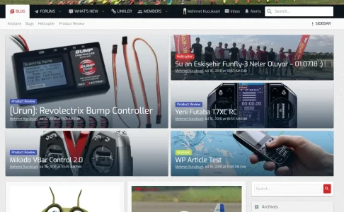

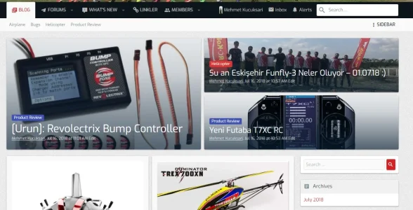

Hi @Mike Creuzer - adding the featured tag does not show the slider for me? I have the grid, but no slider, despite trying featured and Featured.

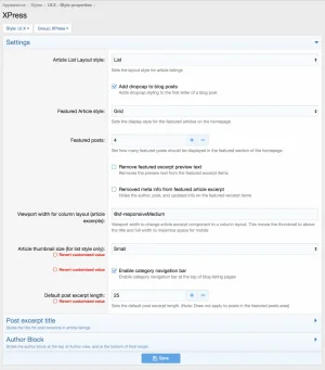

Where is the slider pulling the image from? I've added a featured image to a WP post and also added the tag "Featured" - But still no slider is appearing on the home page (blog)

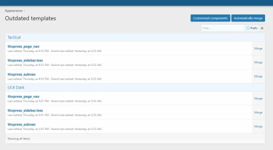

I am thinking you can just save the templates, not sure why they are flagging there, might just be install order, happens sometimes. Not any issue I would worry about. If it happens next time you upgrade let me know.
Yes, this is just the way it is, XenForo flags when it thinks something is outdated. I've not wrapped my head around it as I've always just manually checked for merges. Since not everyone knows how to do that quickly, most times simply saving it is indeed OK, you're trusting that there are actually not merge errors, but if you're on latest everything you're trusting that we're up to date with at least that version.Have a similar problem while installing TH Nodes addon to over UI.X2 theme. I opened a ticket and get the following solution from @Ian Hitt
The issue is that it is customized in UI.X specifically (and intentionally) which is why it does not happen in the default theme. However, since the theme was installed first, It is showing that the child theme is customized, but edited more recently that the parent (which is the add-on.) XenForo foes not know how to resolved these issues because it can only merge from parent to child, not the other way around.
To correct it, you can simply copy the contents of the template, revert the template, and then paste/save the contents again. In XenForo 1 simply saving the template would tell XF to stop flagging it as outdated, but there is an issue with the current release that is preventing that from working properly at the moment.

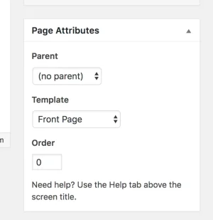

You forgot one step in your post above also regarding the Slider. You also need to go into Wordpress - > Settings > Reading > Then set page you created (Home) as Static. Interesting, when you try to do this via the front end customizer, it states I do not have high enough permissions to do this - but back end works fine.
Once I did this, slider worked - but may want to add to the above for others who are unfamiliar with Wordpress.

Great, get a slider at the endOnce I did this, slider worked - but may want to add to the above for others who are unfamiliar with Wordpress.
