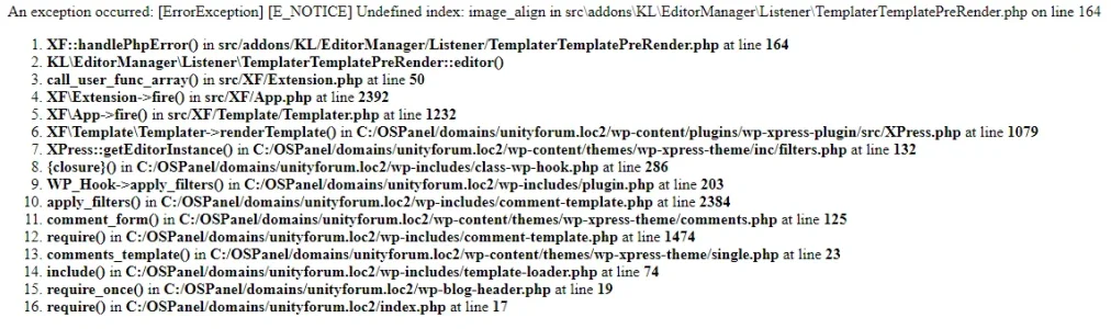

image_align index.Is there a way to fix it before the editor manager update (if it is going to be)?That's an issue in the editor manager.
