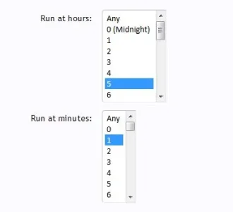

Check your Cron Job settings. What I've found is that you have to tweak the hours within the settings screen for the cron in order to get the actual time to display right on the cron overview screen. This was an issue with Forum Backup addon as well but he fixed that one. This one, every time you upgrade, it reverts that to the default (unless it got fixed....)
I have one thing the smacked me a few times but it's not related to this addon. When changing settings via mobile in iOS if you for instance change the check mark on a time selection, like for the cron for instance, so that it runs at an offset time, then save, it actually checks the "all" at the top of the list in addition to your selection even if you uncheck it. You have to make the change, then edit it again and uncheck all. One time I forgot to do that and it ran the cron every hour and created 10 contest threads and albums by the time I caught it. Again nothing to do with this addon...I should probably write that one up, I don't even know if it's a XF bug or an iOS glitch though....
Floyrd could you give more info on that time fixing exactly so that I know what to fix please ?
Clément
It's pretty much as I explained. The time on the Cron Entries screen in ACP where all cron jobs are listed does not synch up with the time selected on the individual Cron Edit screen. For instance when I install it or upgrade it, the cron is actually set (on the MOTM cron edit screen) to midnight but on the Cron Entries list, the time that it is actually going to run it 7pm (5 hours earlier) because I am in the central time zone (GMT -5) so whatever is entered on the MOTM Cron Edit screen, I have to adjust +5 hours to make it actually run when I want it to. So if I want the cron to run at 12:01am then I have to set it to run at 5:01am and save it, and then on the Cron Entries screen it will show 12:01am.
Thanks for this. It makes sense for one of my issues but the duplicate threads being created I suspect is something else. I've had this happen with any and all versions of this addon in any mode. Problem is that it's very intermittent and no errors are captured anywhere.
That's not an addon issue, that's just a case of the XenForo time not matching the time zone of the server.
I thought it was something related to your addon, because you fixed it, plus I don't generally have the issue with other addons. Or...maybe I do and just don't notice it because they don't actively affect site functions.
The issue with the time difference in general kind of perplexes me honestly. It's totally unexpected.
This all does seem odd, but if the date is not the one expected in the cron time then it's not coming from the add-on.
The cron itself is a xF feature and I just provide execution functions that binds to it.
