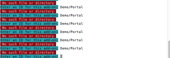

Verbose isnt giving me any more cluse
dmba2:XF2 dmba$ php cmd.php xf-addon:create --verbose
Enter an ID for this add-on: Silvertails/demo
No such file or directory

Im having the same issue No such file or directory and when I changed conf.php from localhost to 127.0.0.1 I get connection refused.
Same issue. The tutorial listed here doesn't work on MAMP / Mac.
Changed the config file to have 127.0.0.1 and it still doesn't work.
Any further suggestions on getting the tutorial to work as detailed?

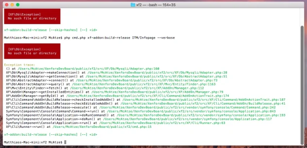

Whats should i do with this error message? I use the scotchbox like you describe in the dev docs.
Doesn't look like you've connected to your ScotchBox. Go to the base directory and enter vagrant ssh. This should connect you to your vagrant box. Go to the xenforo directory, probably somewhere in /var/www/, and run the command from there.
