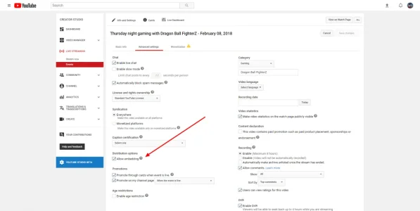

Well, it was live at the time I tried to add it. Still didn't work. To test I just took a random stream that was live now, tried to add it, and it didn't work. No video or chat.
Did you wait for a scrape? Or force one?
How long has it been live? YouTube API is slow to update. Do you have a link?
That would be because that specific channel has video embedding disabled for their channel.
huh, didn't know that was a thing. Can you give a YT link to a stream that works on your end? Just so I can test to see how it looks.
