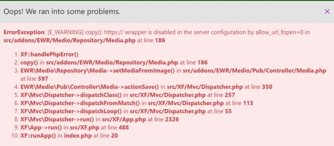

I'm having a lot of problems getting this right. I suspect it's the Google api. I've tried multiple api's, several new projects, rebooted my server, and still getting error messages every time I try to upload a video. Ironically, oftentimes the video is uploaded and viewable even after getting the error message.. This is the latest error message I've gotten, the others are mostly just the Ooops! We ran into some problems. At least this one lists some clues to what the problem may be. error_medio.webp
Your server has the copy() function via allow_url_fopen=0 disabled. Basically, your server has disabled the ability to copy files from an external URL. Enable it.
