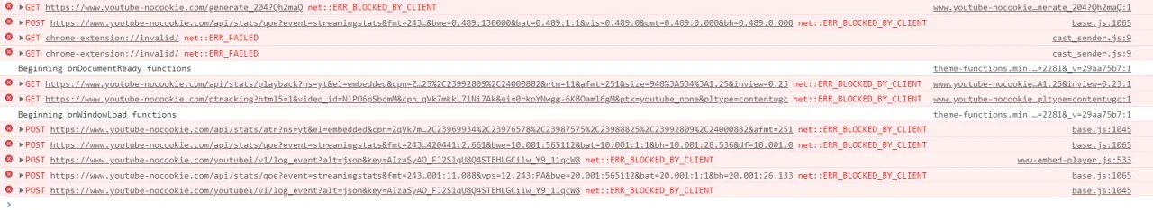

i just had to replace our you tube api again.....while i was in there, i sorted that hack for the instructional comment i was after, but then i noticed errors streaming into the dev tools console after only a few seconds....perhaps why they keep blocking the api after so long?
either way any ideas about this or how to avoid it? did i miss a config somewhere?
thank you
EDIT: well.....nevermind! i quickly realized it was brave browser throwing a hand in things...no worries...it would be nice to know the you tube api will hold tho, not even sure how long it was down this time....people dont even want to be bothered to report issues sometimes, guess i have to just keep checking...
