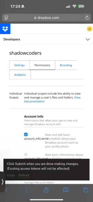

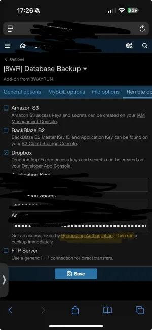

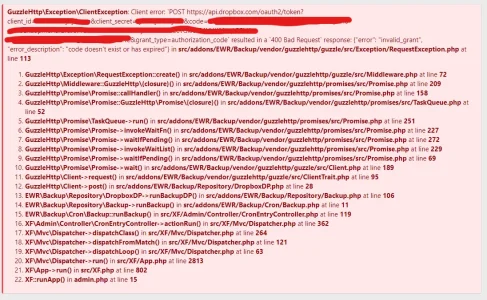

Thank you so much. I found where I need to go to back up manually, but unfortunately, the backup to Dropbox didn't work. So, I sent an email to the developer. I'm not sure what the issue was. Are you using Dropbox with this?
No, I save to root directory then download manually.
This is the error I am getting. I don’t have any FTP space available, which is why I’m solely focused on using Dropbox.
