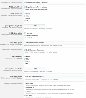

Hi,
we have the add-on bought and installed on one forum. For Database everything works as expected. Split works gz works.
For the file structure split does not seem to work. Background Database is about 5GB uncompressed and structured Data around 550GB.
Maybe I did some settings not correctly:
And one more question is there a way to cancel the backup job from the admin console (web access) ? As the job runs around 14-15 hours at the moment and that makes testing quite hard.
Thanks for any help,
Stefan
P.S.: OMG after now the Backup finished making the structure.tar it begins the split ... hmm ... maybe would be an optimisation to integrate the split right with the tar so not double the space is needed.
Splitting is a two step process. It does the backup first, which as you said, takes 15 hours. It then splits it after the fact... who knows how long that will take... or if your server timed out during the backup and the splitting never even got started.
