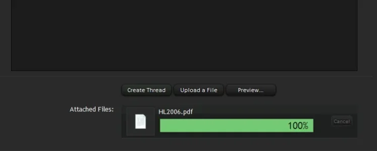

hi
in xf 1.0
when uploading attachment of pdf file of 11mb, its stucked to 100%
and thus the file cant be attached.
note:
-max size attachment was set to 20mb
-flash uploader was used

Confirmed 20mb pdf stuck on 100%
I have 128mb post and upload with 0 timeout in PHP also
I can reproduce this by setting post & upload to 128M as you have, my memory limit is also set at 128M.
Increasing this to 512M & restarting apache sees the pdf upload fine :)

#6
There are several PHP settings that need to be increased to support large uploads. You will need to add the following lines to your .htaccess:
php_value upload_max_filesize 20M
php_value post_max_size 20M

#9
thanks.
i realized you should double + extra your memory limit to the max file size.
ex for 20mb file, set it to 50mb
