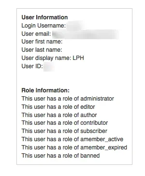

I've been trying to hunt down the issue with WP posts having different IDs from the author. This is a rather wild one - appears on some sites and not on others. In multisite - appears on some blogs and not on others.
To help, I added some code to the /xf_integration/admin/xf_readme.php file.
Same user, logged in to a different blog on multisite
Notice that different roles are being assigned ... strange eh?

It isn't pretty but gets more information to the logged in users.
