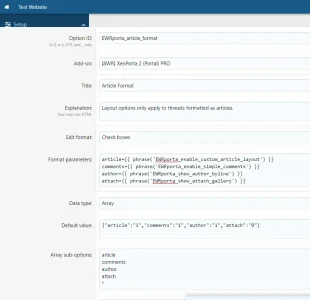

4. Regarding the custom article layout box; I would recommend making use of <xf:dependent>
Here's a quick example of how it would work:
<xf:checkboxrow>
    <xf:option name="fieldName" value="{$value}" selected="{$selected}"
        label="Enable custom article layout">
        <xf:dependent>
            <xf:checkbox>
                <xf:option name="fieldName2" selected="{$selected2}">Phrase 2</xf:option>
            </xf:checkbox>
            <xf:checkbox>
                <xf:option name="fieldName3" selected="{$selected3}">Phrase 3</xf:option>
            </xf:checkbox>
            <xf:checkbox>
                <xf:option name="fieldName4" selected="{$selected4}">Phrase 4</xf:option>
            </xf:checkbox>
        </xf:dependent>
    </xf:option>
</xf:checkboxrow>
If you do it this way, it's clear to the user that the options do not apply if the custom article layout box isn't ticked. PHP wise, there's literally no difference between your current way and this way, it's just a minor HTML change that improves usability :)
I use that in some places... but in the case of the admin CP, I didn't feel the need to make an entire template, for what is essentially just four checkboxes.
Why would you need a new template? The code I posted goes in place of your 4 existing checkboxes, you'd just put the 3 new checkboxes inside the <xf:dependent>

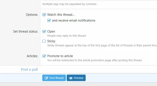

I like the Load More button, that's gonna be pretty useful. A few more questions / feedback:
1. Can you add an option to the New Thread page to promote to article?
I understand that your existing promote to article feature requires the thread to already be posted (otherwise loading attachments for the drop-down would be way too much bother to be worth the time, etc), so you could redirect to the promote page after thread save instead of trying to add the options in-line.
(Overlay popups can function as separate pages too, so you won't need any extra coding to support it)
2. If you implement #1, can you also make a per-forum setting that specifies whether new threads have the "promote to article" checkbox ticked by default?
3. If you implement #2, would it be possible to get a "New Article" button on the home page that opens a stripped version of XF2's "Post thread..." button from the forum home page, only listing the forums in which the current user has article promotion powers?
You could simply redirect to the standard XF new thread interface just like the "Post thread..." overlay does.
4. If custom break text is specified, should the ellipsis be shown after the break text?
5. Personally I think it would look better if the break text is shown on a separate line, so there would be a clean line break then an empty line, then the break text, but that's my personal opinion :)
6. I don't know if your beta testers noticed it, but the breadcrumb on the "edit author byline" page is broken, it says $author.author_name instead of the actual user name ;)
7. When managing a feature, would it be possible to use the BB Code Media Site feature (specifically, match_urls) to extract media ID from things like YouTube? From experience I know that asking users to pick IDs out of a URL is like asking them to hold a lecture on quantum physics while speaking Klingon.
PS: I see you too are a man of taste, C.G.P. Grey is awesome :D

@DragonByte Tech
There is now an option on the "post thread" page:
In your admin CP, there is is an addon option to select specific forums. Any forums selected, will have this box checked automatically.
This solves #1 and #2 of your request.
Perfect, thank you :)
Anything to reduce the friction of posting articles is a good thing IMO, once this is released I'll show it to the admin team of the forum I mentioned (along with the video).
Fillip
