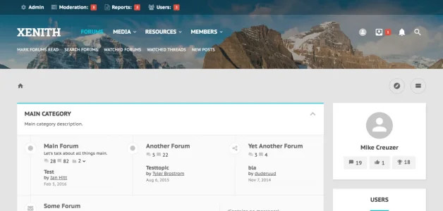

The top is 1.5.4.0, bottom 1.5.6.0.
One key difference is that the space was tightened up slightly (the tablinks moved up a bit), but besides this, flipping through tab to tab, the headers line up about the same. There is some extra space on the tablinks, a bug I noted and will fix. But bug is a tough word...

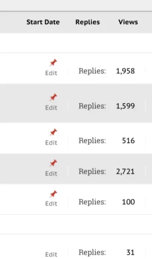

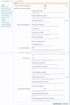

I'm still on 1.5.4 and I'm having a problem where in the Thread List View, the "Replies" stat is showing, but the "Views" stat is not showing.
I went into the setting on our test site (which is a recent clone of our live site) and changed the vertical padding for the list view from 10px back to the default 20px and then also removed the Last Post Avatar. This resolved the issue such that the "Views" stat started showing on the test site. I then did the same on the live site, but for some reason this didn't fix it there.
Below is a screenshot of our current UI.X Threads settings on the live site.

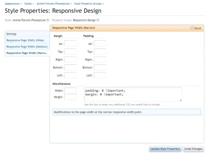

Anyone know how to make nodes 100% width on mobile?
I wanna remove the grey space either side.
Also, I cannot center the logo no matter what I try.
Okay, logo is centered and I almost have it how I want. Just this spacing problem here...
Any idea how to fix?
Try adding this to: Your child style > Style Properties: Responsive Design > Responsive Page Width (Narrow) > Miscellaneous
padding: 0 !important;
margin: 0 !important;
Only issue is this also affects the header/logo and thread titles with no padding, most likely there's a more elegant way.

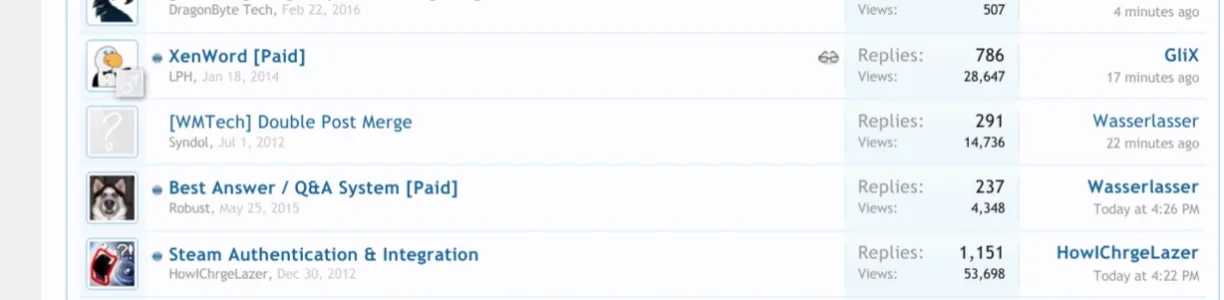

Is there a way to have bold titles like we do in the stock XF style for unread threads? Add on Releases   XenForo Community.webp

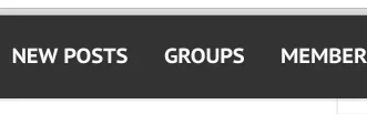

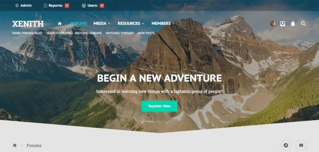

Additionally, I'm playing with Xenith version 1.5.6, and I am seeing that in the sticky nav bar, the tabs are sitting off center on the vertical axis, where as they used to be right in the middle on the vertical axis.
This is before: Screenshot 2016-03-25 at 6.25.23 PM.webp
This is now:Screenshot 2016-03-25 at 6.25.54 PM.webp
You can see multiple key differences there, as I've already outlined;
  • Main navigation - the spacing between each is wider. Just look at how further to the right 'Members' is in v1.5.6 compared to v1.5.4. This causes major issues for those with 6+ main navigation items, and them now being within an elipse (...) menu on desktop and out-of-sight.
  • Moderator bar - same, width between items has been increased.
  • If you navigation style ( style-properties&group=uix_navigation ) = 'float logo next to navigation', there is considerable impact from "tightening up slightly of tablinks" as per screenshot in https://xenforo.com/community/threads/xenith-paid.100756/page-31#post-1049609

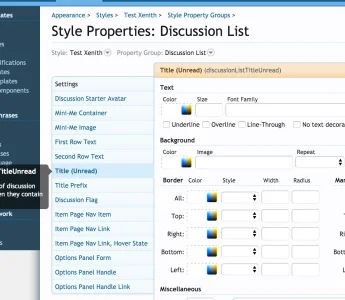

Yes, under Discussion List style properties.
This is before:
screenshot-2016-03-25-at-6-25-23-pm-png.131332
This is now:
screenshot-2016-03-25-at-6-25-54-pm-png.131331
Hard to tell, but it doesn't do this on our demo.
I've taken a look at this. We did change how we do margins, and I'd agree it can be better, so just did some tweaks on my end.
I don't have this issue on my demo, but it could be related to the fix I did.
