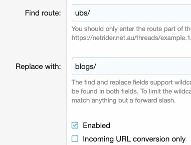

I'm finding this official add-on causes "The requested page could not be found." error when used with route filters.
I have a route filter of;
With this add-on active, I get "The requested page could not be found." errors on multiple pages within the /blogs/ path. For example;
/blogs/blog/create
/blogs/add
/blogs/blog/
With this add-on disabled, no errors occur.
Is this an intention/consequence of this add-on to cause these errors with route filters, or a bug?
thomas1
/blogs/blog/create
/blogs/add
/blogs/blog/
I can confirm this behaviour. We eventually switched our route filters to /journals instead of /blogs which works. Would be great to hear from the developers. :)
Mike
XenForo developer
Staff member
It's mostly because that URL fits the format of what we potentially expect as a blog redirect. I don't think there would really be a workaround at this time short of code changes.
Mouth
I would be good if this add-on had option(s) to select/tick the applicable redirect (modules) to operate and/or it checked for XF route filters and didn't operate against those.
thomas1
I support this motion and hope the developers will consider implementing those options.
