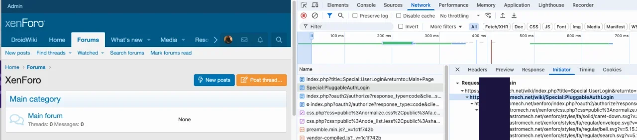

Thank you again, now lets see if I can get all this into on post. Really convinced it a configuration error at this point. Let me know if you want me to pull more to review.
After I click on Log in with XenForo it dumps into XenForo no pop ups
1st URL in Request Initiator Chain (confirmed in XenForo Admin OAuth setup)
Request URL:
https://teststar2.astromech.net/wiki/index.php?title=Special:UserLogin&returnto=Main+Page
Request Method:
POST
Status Code:
302 Found
Remote Address:
8.8.8.8:443
Referrer Policy:
strict-origin-when-cross-origin
2nd URL in Request Initiator Chain (confirmed in XenForo Admin OAuth setup) DID not match redirectUri in LocalSettings. (Corrected)
General Header
Request URL:
https://teststar2.astromech.net/wiki/Special:PluggableAuthLogin
Request Method:
GET
Status Code:
302 Found
Remote Address:
8.8.8.8:443
Referrer Policy:
===Response Headers===
connection:
Keep-Alive
content-length:
0
content-type:
text/html; charset=UTF-8
date:
Wed, 30 Apr 2025 00:11:18 GMT
keep-alive:
timeout=5, max=99
location:
https://teststar2.astromech.net/xenforo/index.php?oauth2/authorize?response_type=code&client_id=0000000000000007&redirect_uri=https%3A%2F%2Fteststar2.astromech.net%2Fwiki%2Findex.php%2FSpecial%3APluggableAuthLogin&scope=user%3Aread&state=RRRRRRRRRRR7RRRRRRRRRRRRRRRRRRRR_RRRR_1RRR
server:
Apache/2.4.62 (Ubuntu)
x-content-type-options:
nosniff
x-request-id:
2b2ed568155a0df2ff16f486
3rd URL Now in XenForo
Request URL:
Request Method:
GET
Status Code:
200 OK (from service worker)
Referrer Policy:

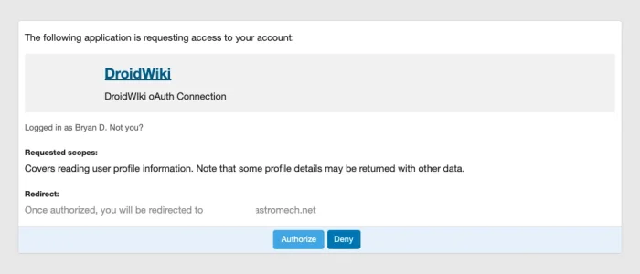

Thanks again for the help so far and sorry, to confuse you. Maybe seeing it will help understanding what we are seeing. Below is a quick video of what I am seeing. The Request Initiator Chain photo is from the last webpage in the video. The code replies in the post above are me clicking through the header. Getting together with another person on our team to see if we can find out what really is the correct / canonical url.
Video
View attachment Screen Recording 2025-04-30 at 9.36.32 PM.mov

Solution
Glad it's working now :)
I'd consider to not use the XenForo username as MediaWiki username as it's not immutable, eg. if a username is changed in XenForo MW will see this a new user afterwards.
Good point, digging more into it I was thinking of using maybe email for this but that that is the same problem as the username. I found that XenForo returns "user_id": 889996, so maybe that could be the driver, and MediaWiki uses a user_id is the primary key. I guess if this was a new Wiki setup we could just try and force the IDs to match. Otherwise I was thinking this would have to all go into a custom table to look up the XenForo ID with the matching Mediawiki ID. At that point I was like hmm, maybe we just let this go as is.
I did turn on migrateUsersByUsername but not sure it really is doing at thing.
In the mean time I was working mapping XenForo group to MediaWiki groups. Ideally, we want the XenForo to be the driver of Wiki user rights assignments too. XenForo on accounts with multiple groups fields in "user_group_id": 2, but not the name of the group. Also it will return, secondary groups too. "secondary_group_ids": [ 3,4 ],
