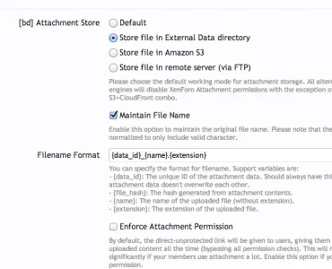

Btw, @DRE, you installed [bd] Attachment Store on the source forum or on the target forum? If you have it installed in source forum, you need to rebuild attachment with default mode to move all files back into their original location. Or your import will fail ;)
I don't know really. I find it a bit strange because `$attachments` was not queried with any kind of keys so array_keys will simply array indeces. I could be wrong though...

If you didn't rebuild it, the importer will fail without any error. It will just ignore the attachments in external data/Amazon S3/FTP (it will import attachments in default just fine). You still need to figure out what caused the current error.
