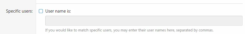

When adding a new trophy you can specify usernames in the "Award this trophy if..." panel.
However, if the user changes their name it would be different from the text typed in this field. Wouldn't that cause them to lose the trophy?

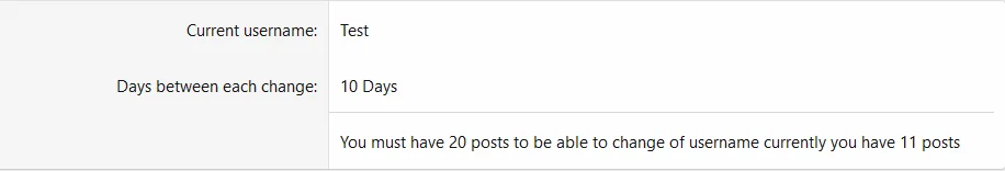

Error when the user does not have the required posts amount required :
Error when...
