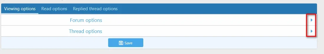

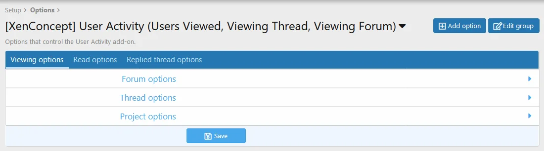

I think this add-on should check if Project Manager add-on installed or not? If not installed then should not add Project Manager add-on option.
