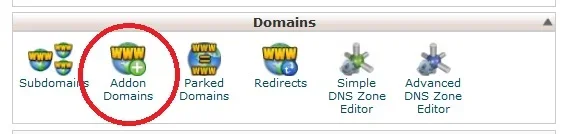

If you run cPanel, you then add your 2nd (3rd etc) domain in cPanel by using the Addon Domain but making the files location the same as the location where you installed XF in domain 1
Example, after you have installed XF and running the way you want it go to cPanel and click addon domain:

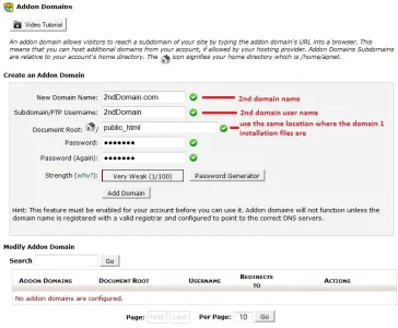

Then add the 2nd domain details but make sure you select where the files are located for domain 1 as the Document Root...in 99% of cases it will simply be "public_html"...when adding the domain it will try and enter a different folder after the public_html but remove that and just leave public_html:
Now install the framework and then the addon and go to the Manage Sites area. Create an entry for each of the two domains (or 3rd etc) selecting the parameters that you want.
Now you have two sites using the one XF installation.
