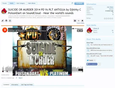

For the first problem of the lengthy URL, could you please run this database query in PHP My Admin?
ALTER TABLE xengallery_media CHANGE media_tag media_tag TEXT DEFAULT NULL
I have made that change in the upcoming XMG 2.1.

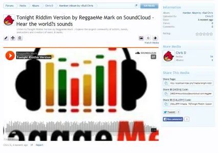

For the second problem, it looks like that one might not have been parsed properly but that could be down to the Sound Cloud BB Code you're using or some issue communicating with Sound Cloud or something like that. I can't help too much with that because all we display is the HTML generated by the BB Code system.
That being said, after making the change above and trying with your original URL that threw the error:
It seems to work fine.
I used the same as yours and it is working fine.
What is the second URL you used?
Then I would recommend seeking support from the author of the Sound Cloud BB Code you're using or to use the BB Code that @Martok recommended earlier.
ok this bbcode works. thanks

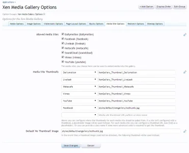

I have my own video site that I added it but the thumbnails is not loading how would I fix that?
You can set up thumbnails for media sites in options:
Unless the provider of the media site makes it easy to fetch their thumbnails, it may require custom development to retrieve the thumbnail path from their API. Or you could just upload a standard image that appears for every video that uses that media site.

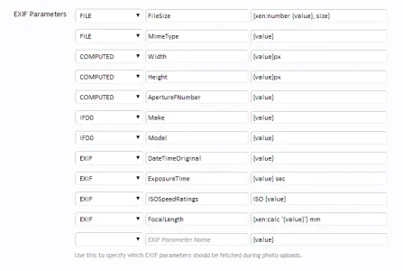

This is the default EXIF data that is set up automatically:

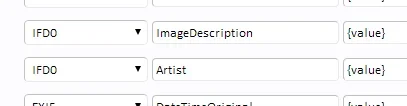

I have added some others at http://xenmediagallery.com:

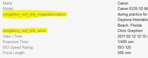

To ensure custom EXIF attributes can be shown and to ensure people can translate them and give them friendly names, etc. you have to create the phrases for them. And I forgot to do that.
Check again, I have added the phrases now :)
