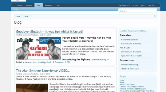

On the plus side I got xfrocks' WordPress Proxy to work using this bridge!
