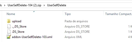

Thanks for the answer!
But I already did this. Redownloaded (just now) from here and inside the ZIP the XML file is "addon-UserSelfDelete-103.xml"
And the header of the XML is:
Maybe the incorrect XML was accidentally put in the package?
There was indeed an error in the version number of the most recent XML. The download has been corrected.
However, the bugfixed files were included in the zip. If you still experience this bug you haven't uploaded the most recent files or not overwritten your previous files.
Please upload the files and try again. Take care that you upload the most recent version and overwrite all files at your server.

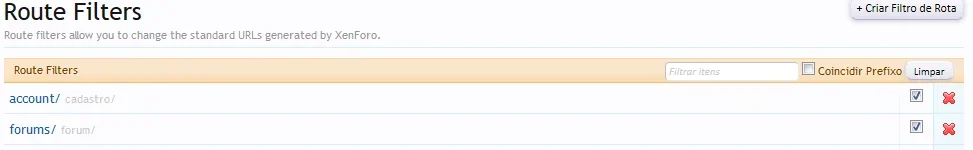

The problem seem to be about the Route Filters. We have a route filter for "/account" mapping it to "/cadastro" (to make the URL more friendly to our public - Portuguese speakers from Brazil). When I disable this route filter the add-on works nicely, but with the route filter on, it enters a redirect loop when the user already selected to be deleted.
I believe that's something with function frontControllerPreView in Listener.php
I tried adding some route filters like "/account/delete-account" but it didn't work. My route filters:
You are right!
This add-on is currently not compatible with a route filter for the /account route. I am sorry, but you'll have to deactivate this route filter if you want to use this add-on.
You are right!
Thanks for your time =] I can't deactivate the route filter but I edited the Listener.php from "/account" to "/cadastro" in lines 89 and 93 and it worked
