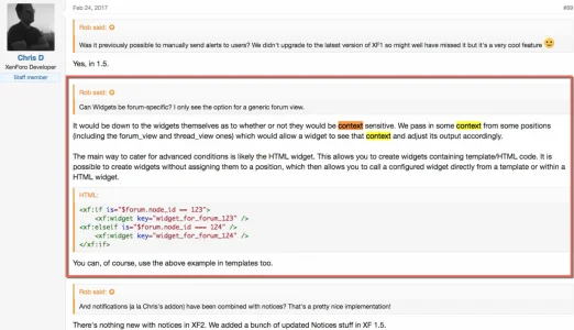

Sorry I misread the "HTML widget" bit for some reason.
The description that comes up when that position is selected says that the "$category" is received as context though admittedly what this actually means isn't clear (the wording has been adjusted for the next release).
The code you would actually need is:
HTML:
<xf:if is="$context.category.node_id == 15">
    <xf:widget key="bmNewThread" />
</xf:if>

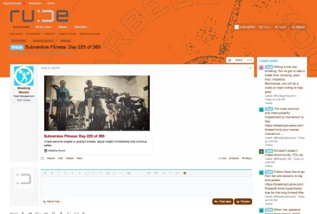

Do you have something specific in mind that you need in this widget or another?
We've just added iFramely to our in dev XF (see attached). Works very well for all those sites that aren't covered in BB media sites. Much quicker than creating BB media codes for each of the 20 plus sites we want to cover.
With this in mind, it would have been great to have added the iFramely code to a widget, which is several degrees of difficulty easier than altering templates or installing plugins - and probably a lot less prone to breaking following upgrades. Much more targeted too.
For this to be feasible I think you'd need to expose an ever present page object, available in all templates, widgets and crucially client side too. It wouldn't need to be the recursive monster you see in many MS cloud offerings, but adding simple things like tag objects, and hierarchical node structure showing name and type etc, would add lots of possibilities - as well having a consistent place to find the current view, controller, url etc.
