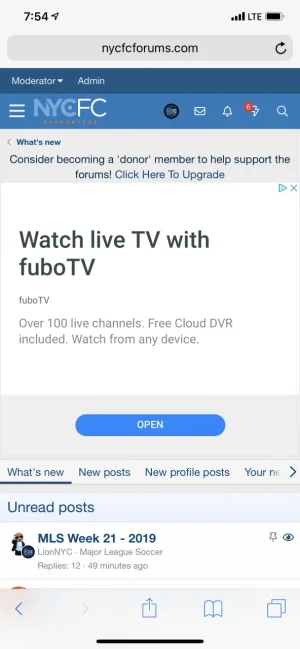

Thanks for the reply. That didn’t solve it. Would it be a template modification?
It’s the little thunderbolt in the top right. It links to what’s new. That actually solved it but for the drop down menu (on mobile).
The thunderbolt is for narrow view ports only.
Test the modification on a desktop with the "What's new" tab. If it shows new posts, then it would tell me that the thunderbolt is hard coded in a template to /whats-new/ and doesn't follow public navigation and would require an edit somewhere.
Edit: Unless it's cached. Clear caches too.
You’re right. If I go landsxapenon my phone the bolt disappears and what’s new links to New Posts. Thank you.
I guess the only issue then would be mobile users still having to go a few extra steps when in narrow view.
I’ll try searching through the templates when I get home. Any guesses as to where it might be?
Thanks for filling me in on that. I'd assume the bolt would take the nav into consideration, but apparently not.
I would've answered much sooner finding it and helping out as @Kirby and @Mr Lucky did, but I use the below add on so the user experience is relatively the same across platforms.
Everything worked. I was able to edit it so that both mobile and desktop take you to new posts, not whats new.

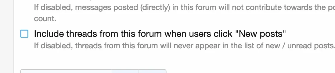

this does not do the trick. I'm looking for the exact same. If I click on NEW POST it does not show all new posts, only from some forums / Nodes and I don't know what the criteria is why it shows from one and not from another forum / node??
Anyone that can help.
Normally that is defined in the node settings
