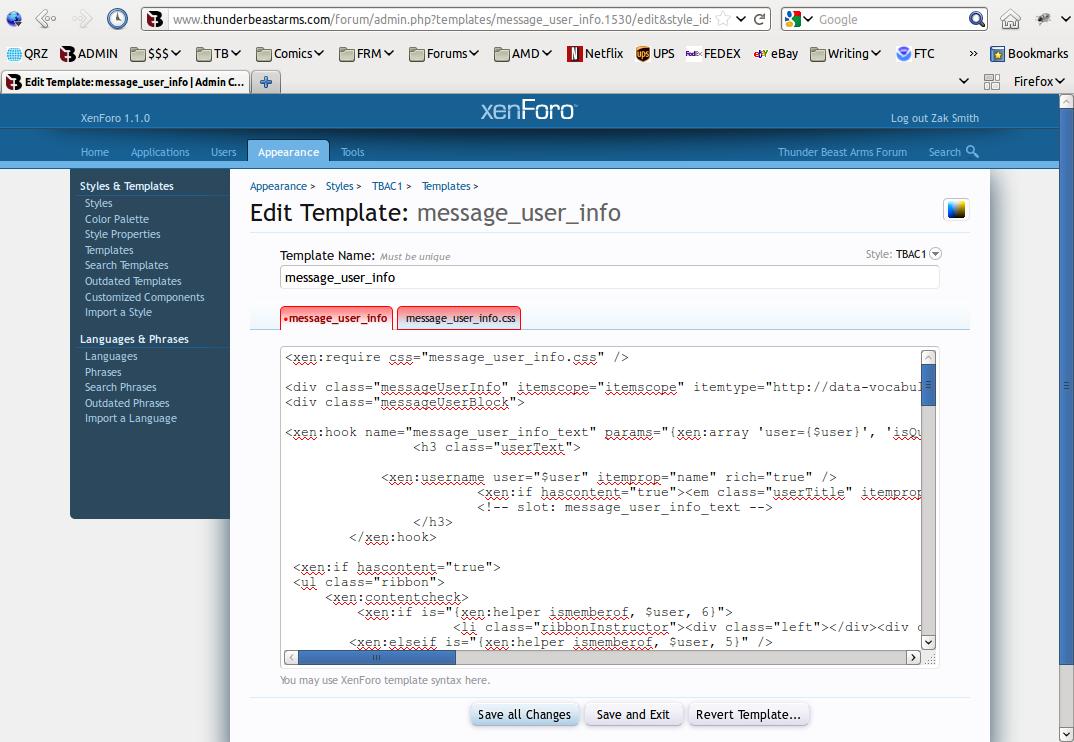

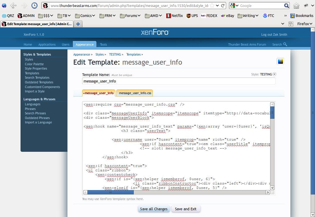

Here's an illustration. In the first capture, we have the one that exhibits part of the issue. In style 3 ("TESTING"), message_user_info was changed a long time ago. It was listed in the Obsoleted Templates list. I did hit Revert from there. But obviously this is still my modified version. Also note that there is no Revert button underneath the text box. So the template inheritance/modification system does not think that it is modified, although it is highlighted as red in the tab above the text box.
In the second example, we have the production version in style 2 ("TBAC1"). I hit Revert from the Obsoleted Templates list, and noticed that when I went back into the template it was still my modified version. So I pulled the version from style 0 ("master"), made my changes, and saved that into style 2 ("TBAC1"). It is the updated 1.1 version with my diffs applied, and there is a "Revert" button under the text both.
Something is clearly confused in the first example.
The red dot in the first example just shows that it thinks that the template has changed from the loaded value, not that there's anything in the DB that's customized. The red background/border in the second shows that it thinks the template is customized.
