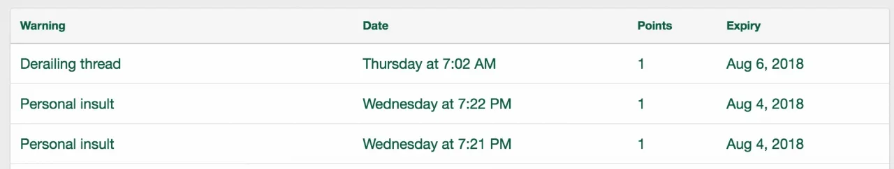

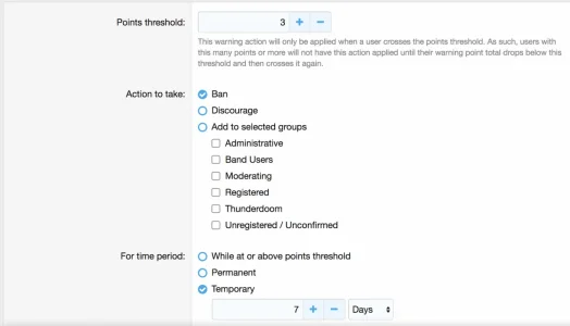

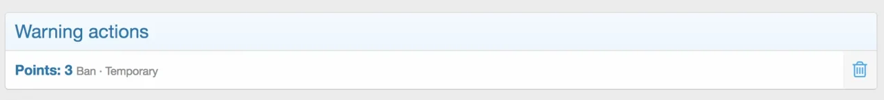

I have it set so that 3 points will equal a temporary ban. This works on new users that have registered since moving from VB4 to XF2, but not on imported users.
