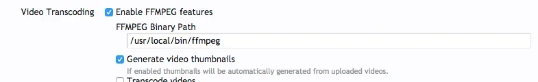

Trying to get video thumbnails and transcoding to work, starting with the thumbnails. I have FFMPEG binaries setup with the appropriate directories and permissions, version N-81300-gce2217b-static. I've tried from an iPhone 5 and a Moto G without success.

Other things to check, are to double check the FFmpeg path is specified correctly and also ensure thumbnail creation is actually switched on:
We don't have thumbnail creation enabled here
