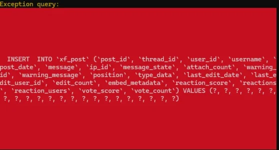

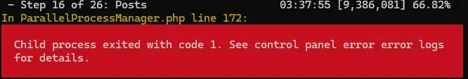

Running a VB3.7 import and having issues and it's failing.
First, lots of this -
00:00:57 [859] 7.82%libpng warning: iCCP: known incorrect sRGB profile
And then it fails at -
In AvatarService.php line 236:
Call to a member function getType() on null
Any advice?

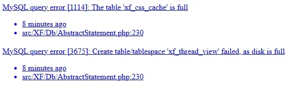

MMM .... should have done the math. Old database, new database, SQL dump file for the transfer I hadn't deleted, plus the VB file tree and Zip of it .... all adds up. Deleted the unnecessary stuff and import has resumed.
Yep. You'll also need overhead for:
and
The DB server import failed at the last minute also, due to HDD space on the webserver. Fixed that and it's gone to "finalize" stage! But ...

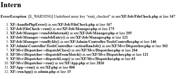

ahh, also tried xf:import-finalize, and it gave a different error -
Nothing comes up in the CP under importing any more, so I've gone and selected to rebuild the cache manually
