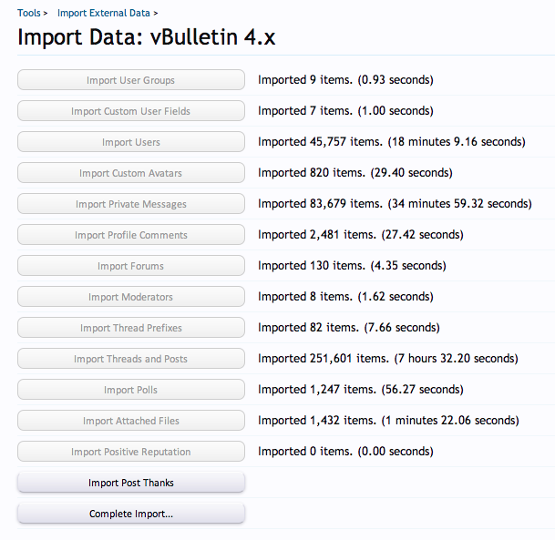

Just to update you, I used this to do a full update on our live site! - We are now free from VB4!!!!!!
For anyone interested, here are some times for the imports :)
The Threads / Posts = over 2m posts :)
