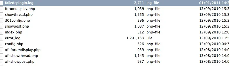

Kier, I have a folder where the VB forum was: /forum
I know I can't remove all files from the folder. I know I added some XF files that I thought were required.
What files do I need to keep? Just the "xf-" ones?
Here's a list of files that were added / updated the most recent.
Interestingly, I thought there was an .htaccess file but I don't see one.

I don't recognise those xf- files, I assume they may be the original vB files that you renamed?
You may delete all the vB files, and then re-upload the files from our redirection scripts package - they do not require any of the original vB files to be present in order to function.
