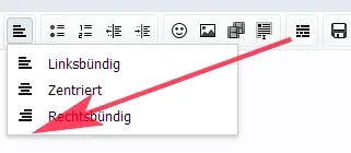

Is there a way, to pack icons into dropdowns like there:
