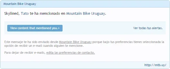

I've updated to the latest version and noticed that the email has a ">" at the end of the phrase.
View content that mentioned you.>
Xon updated User Mentions Improvements by Xon with a new update entry:
Maintenance update
  • Fix typo in alert email.
  • Convert 'Disable User Mentions' to 'Enable User Mentions' permission
    • Defaults setup for any user group or node which had permissions to send user mentions or the former disable user mentions permission.
    • Ensures that user mentions will not be accidently disabled.
  • Fix permission check when the logged in user doesn't match the poster.
  • On uninstall, cleanup left over permissions.
