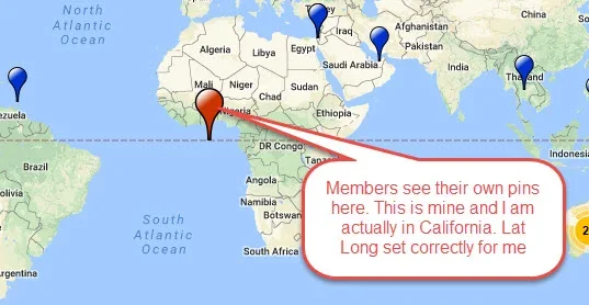

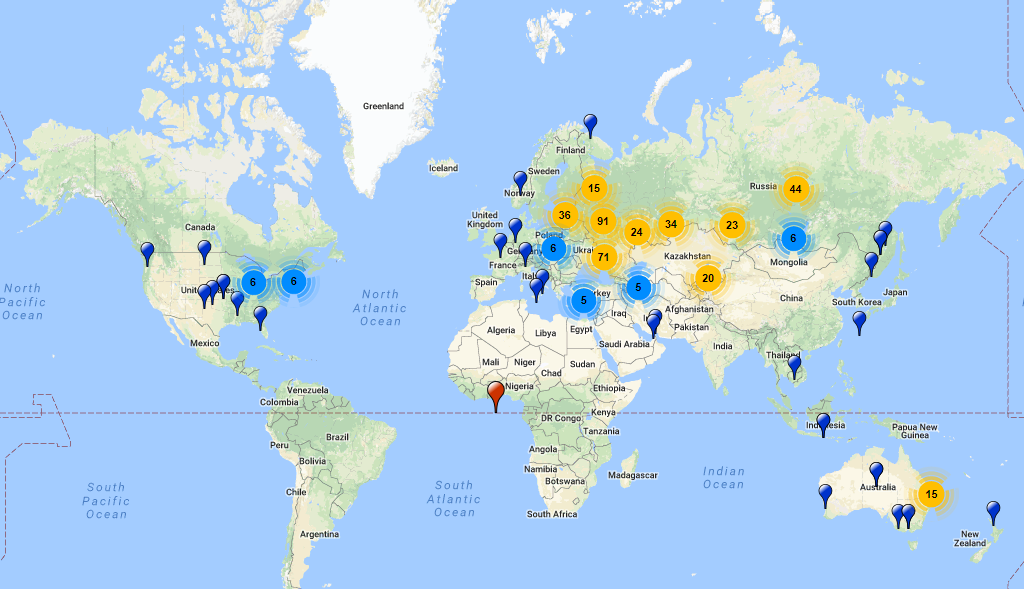

Hello,
I have installed and configured the map add on per instructions. I see the pins or markers for some users. My pin, when I look at it is on the equator by Nigeria and I am in California, same as moderator. In fact every member who looks at their own pin sees that their pin is in the wrong place. By the equator. I have already launched this and now I have many support emails.
If anyone knows how to fix this please let me know. I have not heard back from Crispin and based upon other threads it could take a while to hear back.
Since all pins are not on the map, does this add on gradually add them by cron? I have it set to 2500 per day.

Hi all,
I was able to get it working. Seems ok now. I had to run massupdate several times. The user has to enter the address accurately or they will be seen on the equator near Nigeria. lol
